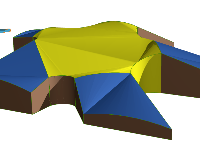

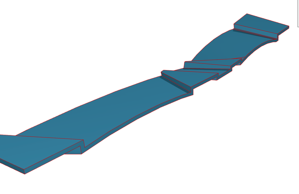

Hi thanks again Ejrolon. - the trick is that there are no straight changes in width - all follow curves.. and trying to join a morph to a mesh without visible seams will be a nightmare...
I was really hoping for a simple lofting technique.
If I am doing the intersections and other complicated parts with mesh anyway, then I might as well do everything with mesh, as the straight parts are just linking straight across between the two complex ends- no nodes in the middle really need extra definition
I know Morph already has a single point bulge tool - I just need a way to consistently extend this bulge along the middle of roads
A couple of examples attached

Paul King
Mentor
... and the second image

Eduardo Rolon
Without having all the information, this is an example using Meshes and Morphs. It is not pretty and I am convinced that if we had specific Civil data it could be made smoother since I am sure that those levels will not work.
