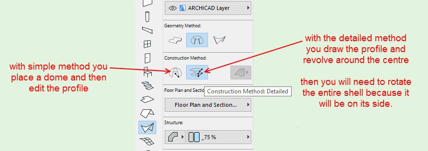

kielbasa wrote:Yes you can draw the profile first - you just need to choose the 'Detailed" construction method.
One question - is it possible to draw a line first and then merge it as a section line , so it's more precise or I just need to draw the dome first and then edit the section on the 3d model ?
