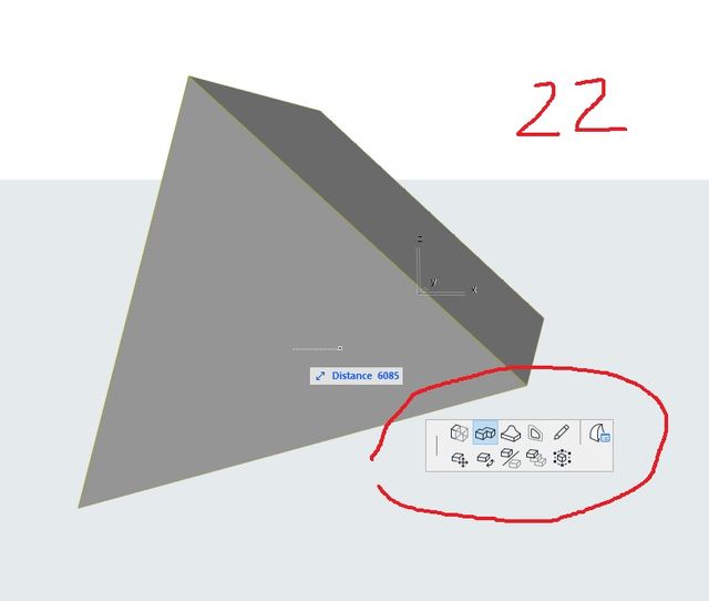

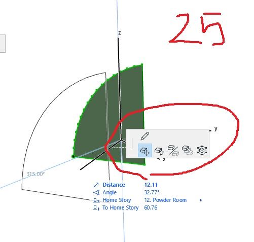

We have recently moved from Archicad 22 to 25. Until now it has been a breeze of a transaction, but I today I got stuck with morph editing.
Maybe it's a little hook missing somewhere. Maybe I am crazy. But I can't edit my morphs the same way as I could in Archicad 22.
Unfortunately because I am not very proficient with morphs (I use them as a last resort only), I am not sure which menu/setting/definition I might need to trigger to be able to get the full menu.
Thank you for your help...
In attachment I have placed a screenshot from archicad 25 versus archicad 22 menu options.

It shouldn't have anything to do with the Work Environment as the pet palette is not user customisable.
Looking at your original post, in the 22 image you have a solid morph.
In the 25 image you have a single morph plane.
The pet palette option will differ depending on what part of the morph you activate it on - edge or surface or corner node of the morph.

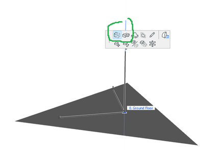

Hi Barry, I have no idea what happened. Fact is - I copy pasted the same morphs to a empty file with the standard work environment and suddenly the menu has everything that I need. Then I loaded my saved profile (which has the menu positions and the shortcuts saved) and the menu was suddenly gone.
The menu option I needed is also available for single morph planes, not just for solids.
Here's a screenshot of the now solved situation:
I can't explain what's the cause, fact is, the problem was solved once I re-saved my profile from scratch. I'm just glad I eventually found a solution even if it might be a happy coincidence.
