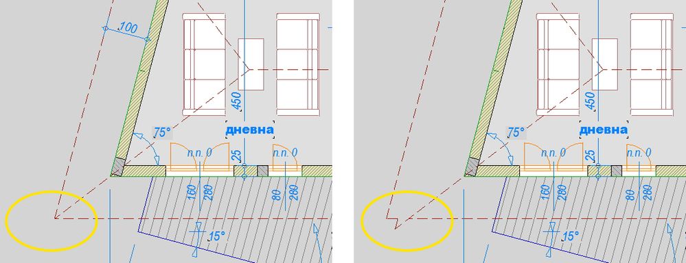

There is a bug in the multi-plane roof (AC7 5005).
I use a multi-plane roof with eaves overhang. When I try to offset the edge of one of the roof’s planes, strange triangular shapes appear at both vertexes of the plane. The size of the triangles seems connected to the thickness of the roof plane. And, as a side effect, all the dimensions, associated with the vertexes of the roof plane, disappear.

Kliment,
Can you please tell me the exact steps to reproduce? And can you show a screenshot of the roof settings? I am trying to reproduce the issue from what I can see in your post but I must be missing something because I cannot. Maybe the specific pitch and thickness have something to do with it.

I am sorry for the late reply, Nicholas!
It seems the bug originates from a corrupt file and does no appear when a new file is created. However, it appears on different computers if the same file is opened.
I could send you the file, if you are interested, though.
