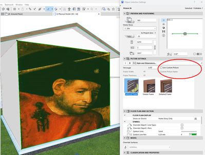

A simple solution is to use the Picture object without a frame. You can use any custom image that you have loaded in the library.

thank you for your help, but i couldn't add a texture to add on my ''morph tool'' generated wall.
You need to define a Surface and specify the desired Texture for it.
Then, you can select an individual Morph face using CTRL+SHIFT+click, and override its Surface with the Surface you defined.
Then, with the Morph face still selected, you can use the Document > Creative Imaging > Align 3D Texture > Set Origin menu command to specify the origin point of the Texture to move it to its desired location on the Morph face.
