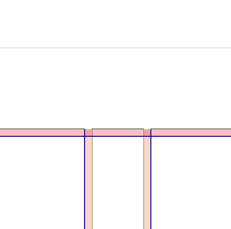

I have a GWB ceiling (done with a composite) and a 2x4 wall with GWB on both sides. I want the GWB ceiling to automatically heal itself around the wall, with the 2x framing running right up to the ceiling framing. Is this possible with just skin priorities themselves or do I need to do SEO's to get it to clean up?
3 REPLIES 3
SEO is one way to clean it up. Wait until the model is mostly built, then perform the SEO on all the walls and the ceiling at once instead of doing it piecemeal in each section.
Bring to front also seems to work in AC14.
Ok thanks for the help.
