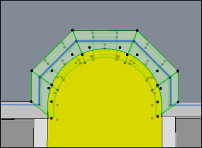

This is something I haven't seen before - SEO with upwards extrusion , looks fine in 3D, does not look fine in 2D.
Any neat little box I haven't ticked??
Any suggestions?

Solid element operations have never been visible in 2D.  This is a long-term wishlist item.
Botonis
Mentor
You can replace wall with a shell and create holes where you can place the openings using a wall. Shell's SEO are reflected in 2d when you set it at floor plan view. Or a curtain wall.....

@Kamelite Have you considered using the polygon mode in the wall tool?

Maybe I should do just that! The matter of the fact is, that I have no prior experience with the polygon mode. This would be a great opportunity to get just that!

Polygon wall worked like a charm!!
