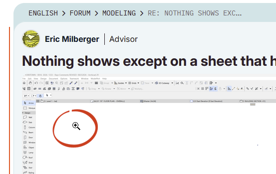

I found this in the spam folder and released it.
Your 3D perspective may not be looking in the correct direction - choose fit in window.
Layers could be turned off.
Or the wrong renovation filter is selected.
4 weeks ago - last edited 4 weeks ago
If you merged an older project into AC29, the Layer Names/Combinations may have changed resulting in all of your old layers all being turned off. The default naming of many things seems to have changed with Libpacks, for AUS anyway...
Ling.
| Win11 | i9 10850K | 64GB | RX6600 | Win11 | 7800X3D | 32GB | RTX5070TI |
4 weeks ago
If Eric can still see the floor plan, it shouldn't be a layer issue.
Also layer names and combinations shouldn't be changing between versions.
Unless the default template has changed over the years.
But that won't be an issue if you maintain you own template.
Also, also the layers have nothing to do with library packs and the only things affected by the library packs should be the objects themselves.

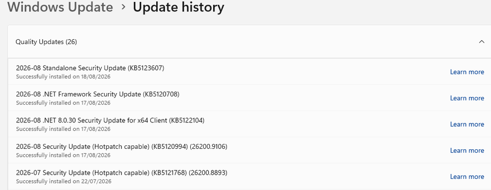

I just noticed...I do get the mouse cursor "zoom" for images that i post, but not for other images(after making this post)
it stopped working recently (within the last 2 weeks)
I only noticed 3 days ago when I tried to look at one of the images.

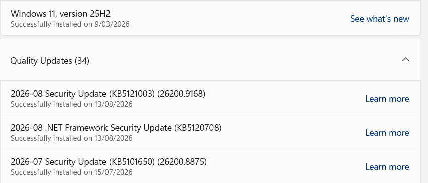

both windows 11 computers had the august security update install, and may have happened then.
Can you check if your windows 11 has the latest , as its really annoying now and it may be related.
windows 11 pro updates
Windows Home

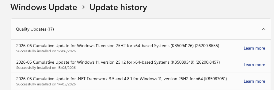

My last update appears to be June so I don't think it is the updates.
I have not noticed the zoom for some time.

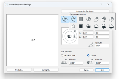

i've had it happen once or twice. changing between perspective/axonometry, or setting one of the predefined axonometric views has resolved it for me.
