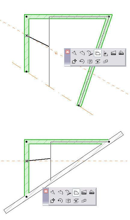

Working with polygon shapes and the Offset edge tool on the pet pallet works fine, it does just what you want.
However, when it comes to editing a polyline or a selection of unclosed elements (see topic on this), such as a selection of walls or lines, then the behaviour can be rather strange.
Select several joined lines/walls and then edit the end one using the Offset edge.
Then what happens is this:
Rather than extending the adjacent elements and keeping the end one at the original length, you find it lengthens or shortens the element, depending on the undrawn line between the first and last element you have selected.
In the example below, the closed shape would be a triangle, and the wall is either lengthened or shortened according to which way you offset.
This is not what I want to happen.
Am I the only one who thinks this is not what the edit should do?

IMHO, I don't think it's a bad thing. What more can you do about edge editing?
If we look at different senarios as illustrsted in the attached image, it might be good to have the invisible vectors which pass through the 1st and last points of the serie of connected elements.
Howard Phua
Win 10, Archicad 19 INT
I think the end segments of the polyline (or selected walls, lines, etc.) should simply retain their original length.
This seems the most commonly desired behavior and easiest to understand.
In the rare cases where one wants the edge to stretch it can be done manually as a second step.

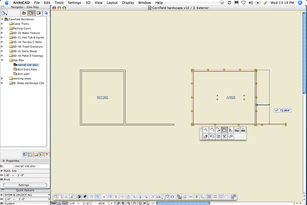

I did a little experimenting and discovered that if the walls are grouped, and groups are then suspended, that offset edge works closer to like we want. The key is that the walls need to form a closed polygon but will still work if one segment extend past the closed shape. The same works for lines and polylines. Things break down if segments extend every which way and T intersections are not maintained. Basically only corners are preserved. At first I was pretty excited, but with all the limitations I still think there's room for improvement.
