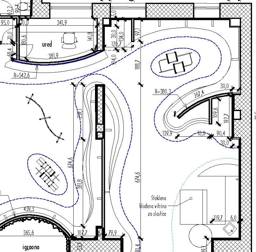

Dwight, I won't call you an idiot, but here's the one corner of the shop so you can see exactly what kind of shelves I had to do. It's not that I'm lazy or whining for no reason...
