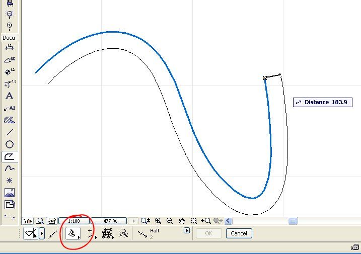

You can offset with a Polyline, but not another spline, using the offset "relative construction method", see image.
With polyline tool active, click on offset button, space-click on spline, define offset direction and distance.

And then you can magic wand a spline onto the offset polyline.
Don't ask why such a silly workaround is necessary - only GS knows the answer to that one!
