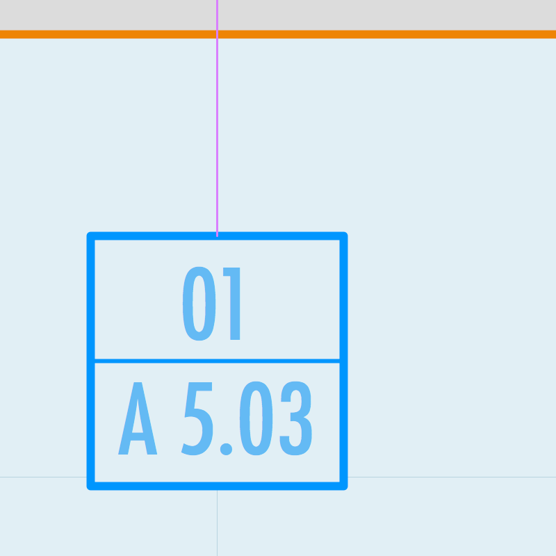

Eduardo Rolon
and with an OpenType font.
It happens with Zones, Grids, Text, Markers and Titles not with Dims.

Eduardo Rolon
and if you add the frame to the text you get…
