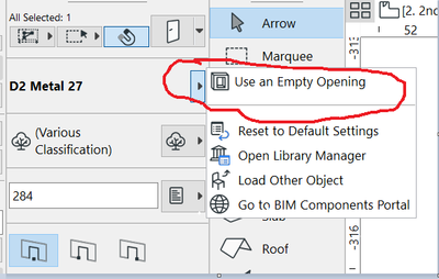

Is there anyway to have a opening linked to a wall so when you copy the wall it also copies the opening, like it does for doors/windows?
Is it also possible to link the anchor point to the wall instead of the floors?

You could always use an empty door or window instead of using the Opening tool.
