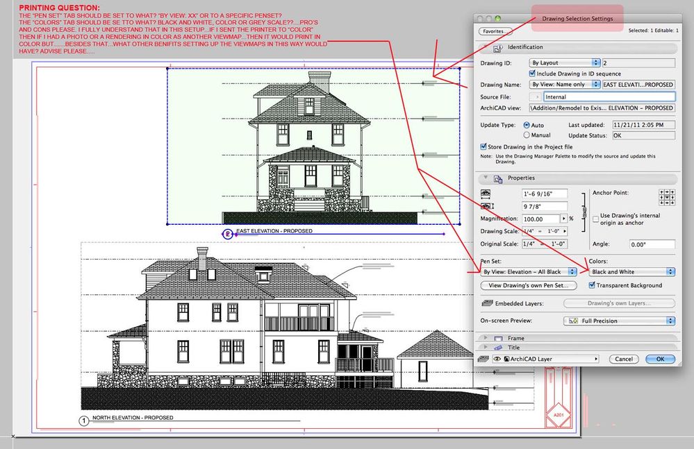

see attached.
I need some opinions here.
i>u
Edgewater, FL!
SOFTWARE VERSION:
Archicad 22, Archicad 23
Windows7 -OS, MAC Maverick OS
13 Replies 13
ArchiCAD is giving us more control for pen sets then we actually need.
1.Every view can have its own pen set
2.When placed on layout, view becomes a drawing and you can assign other pen set to it
3. Above all , in you can override it by changing color in drawing setting to grayscale, black and white, or color...
In your case, as I can see, view has already "all black" pen set, so changing color option on drawing settings will have no effect...

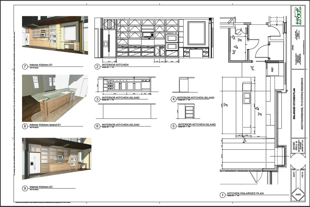

Here is where I can see a sheet like this taking advantage of the settings I've specified above.....where you have 2d viewmaps that print in "Black and White" and where you have viewmaps that will contained "rendered" (color) imagery....whether they be rendered from AC or come in as JPG's from a field report or whatever.....point I'm trying to make is "what's better for viewmap pen setups"?

Here's my thoughts:
http://www.shoegnome.com/tag/pen-sets/
I believe you should always print in color (ei by pen set), with your pen sets controlling what is black, white, grayscale, or color.

ps - nice renderings! Lightworks?

I like to create a pen set for each type of view. Also layer combination, view options and all the view filters.
My personal trick is to give to each filter the same name, which is the name of the view, so it is very easy to manage views on the view schedule - google translate this: http://architruques.blogspot.com/2010/05/indice-de-vistas.html
For instance, if I have an Inverted ceiling plan, I also have a layer combination, a pen set, a view option etc that are called "Inverted Ceiling Plan". Through the schedule I can quickly make sure every filters are rightly applied to every view.

All good points folks....now here's my other delima also associated to the pensets and thicknesses issues of objects...see attached image.
The renderings were indeed done with Lightworks but out of the AC15 box lightworks.....yes...
