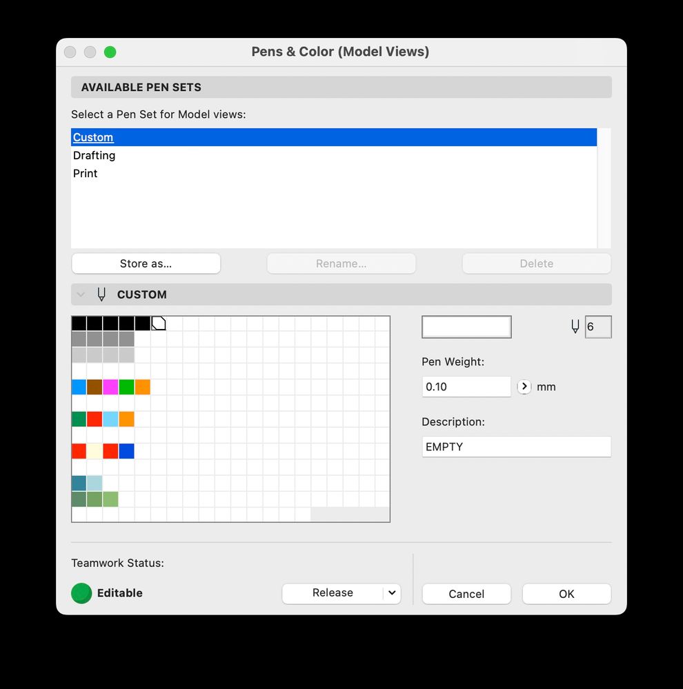

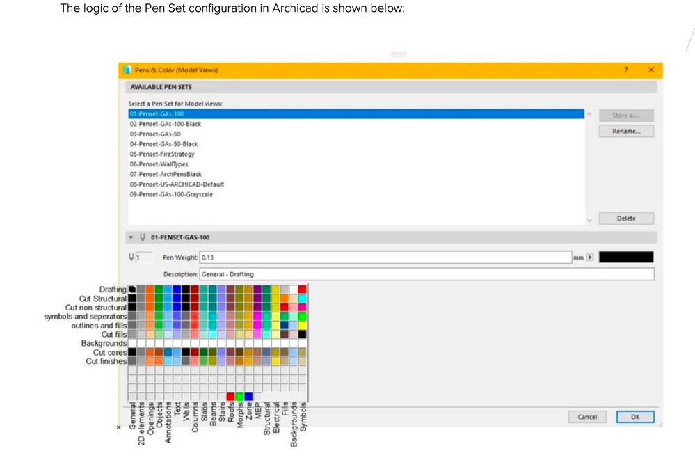

Attached is a Graphisoft diagram which shows the logic of how their pensets are arranged and how they are applied to the built-in library parts. I've also attached our current penset which is very lean and does not follow Graphisoft's logic.
By deleting most of the pens we get simplicity, but it breaks the functionality of the built-in library parts. Would it be better to adapt the Graphisoft pen set in terms of colours and lineweights, but keep all 160 or so pens? We can then add on any extra pens that we need in the unused spaces at the end.

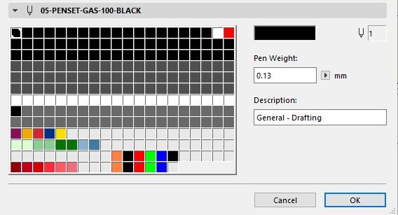

I've attached the one we use, as highlighted we are not using Archicad to its utmost, but I'm eager to improve our own use of the program. There are a lot of settings when you look at it the whole pen set, the left hand column out the box provides most of the black/grey options you seem to use out the box. My understanding of the process is the template file should reduce the need for these to be changed on a project by project, so I don't see the benefit of removing all the others, what is the driver for having fewer preset pens?
The driver (not my own view) would be simplicity. The penset only has one version of each colour/lineweight that we want, so it's easy for users to select the correct pen. There's no distraction or confusion from all of the other pens.
