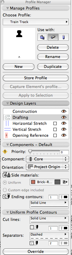

Hello,
I've created a railway track, using custom profiles (beams) but now my ArchiCAD file seems to be very slow. I find that I have to open things gradually in layers in the 3D window just to view them. As you can see from the attachment, the beams are taking up most of the count as I have also inserted sleepers to make the rail track more realistic.
The 'Objects' are 4 Cadimage railings which are around 7metres long... perhaps I should replace them with ArchiCAD parts instead?
The plans open just fine, sections are slow and the 'wait time' in 3D goes up to 166 minutes. I try to stop the 3D process but ArchiCAD crashed.
Is this poly count way to large? How can I 'fix' the problem?

Taking Ralph's illustration # 1 as an example, each curve will generate 9 facets, so that profile would generate about 75 polygons. Chamfers could replace the curves, reducing the polygon count to about 20. You could select one piece of rail and get a polygon count to see how many polygons your custom profiles are generating. Standard beams (rectangles) are as simple already.
David
Turns out that each beam has approx. 760 polygons... there are 10 main beams which form the track. Then there are several hundred sleepers, which are simple default beams (they are 20 polygons). The total poly count of all beams is 40k.
I'm not having a great outcome with OBJECTiVE profiles, they won't bend in the correct shape and they don't join well (pieces protruding on each corner)
How would I change the complex profile complexity? As mentioned earlier, I can apparently eliminate curves and faces and reduce the detail but I don't see these options...

I am thinking that maybe something else is wrong here.
Polycount is pretty low.
GS has put out a white paper about AC performance and in that it mentions that when polycount hits the millions is when things can start to slow down.
So I believe something else must be wrong in here. Maybe there was some operation within or involving those elements that takes much time to perform.
Or maybe calculating the intersection between those Beams takes a lot of time. If you make the Sleepers out of Walls, put them on a different Layer and set a different Layer Intersection Group Number for them, does that change anything?
If you copy-paste these railings into a brand new file started with New &Reset, is it still slow?
Sure, I've just checked the poly count in the white paper and 49K is nothing really...
I've copied the rails and sleepers into a new file (also reset) and it open is 3D very fast, less than 30 seconds I'd say. Should I copy the whole project in the same manner? Would that essentially resolve my issues or just copy them over?
