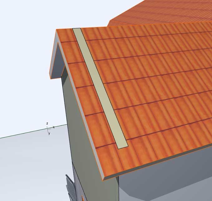

I'm new at archicad and I have a problem. Sometimes my walls sems to be visible through the ceiling? I can't find what it is and why.
Could anyone explain for me why it does that?

This is a result of the Intersection Priority strengths of the Building Materials used for the Roof and Wall. You can either make the Roof stronger than the Wall (when using the Connect command), or use Solid Element Operation (SEO) rather than Connect.

David, thx alot!
The use of SOE did the job.
