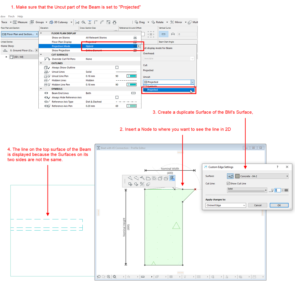

Profile Beam - showing projection of bottom face in plan?
Am I missing something here, is there a better way to show this?
 Here's the best I have so far:
Beam floor plan projection tip
1 Reply 1
I have a solution:
Make sure that the Uncut part of the Beam is set to Projected. Then, in the Profile Manager, create a new Node on the top edge of the Beam Profile exactly above the vertical edge you want to see in 2D. Then, duplicate the Surface of the Profile's Building Material, and assign it to one of the edges on either side of the inserted Node. Now, in 3D, this will result in the inserted edge being visible because the Surfaces on its two sides are different (they look exactly the same, but their index number is different so they are considered different internally by Archicad.)
