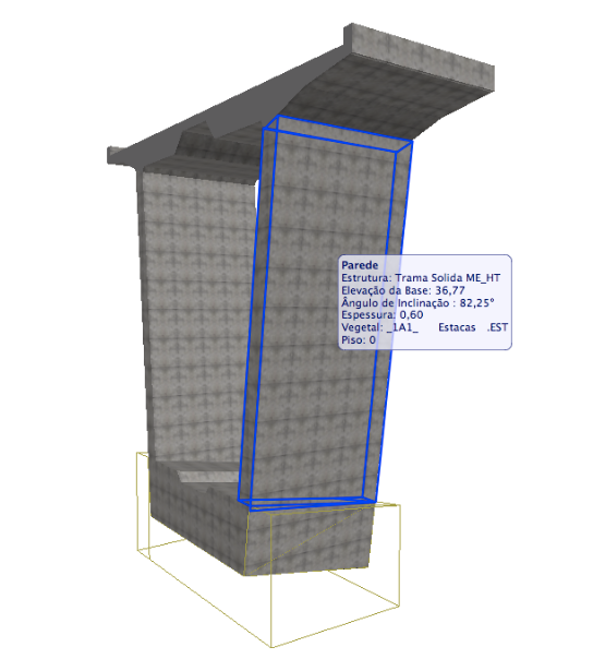

I need to produce profiled elements (objects or any other tool), that have adifferent sections on each top. These are segments of a bridge.
I looked at Cad Garage and Encina tools, and it looks like they are not able to do this.
Had a go in Sketchup, only to find out that AC13 does not support .skp import.
Without buying Sketchup pro (to export in DWG), or going back to AC12, is there a way to do this?
Thank you.

The profile is variable, which means each top is different. Thus I can not use a simple extrude.
Matthew
Yeah... After a brain transplant, maybe.
Peter
Same problem. The ends are different.
I managed to do this with a complex profile for the upper slab (which is constant), slanted walls and a mesh on the bottom (cut by another mesh with SEO). Then I SEO everything, and finally save it a an object.
A lot of work for such a (apparently) simple object, and I do not like to abuse on the SEO gimmick.
Still, thank you for trying to help, you guys are great

2010-03-08 10:05 PM
The top platform is has a constant profile, so that is easy,
The walls are also easy.
The bottom platform changes profile (it gets smaller as we go along), and is also inclined, so this is the tricky part.
That is why I did it with meshes.
The problem with this approach is that I need quantities. Cubic meters is easy, but surfaces for form work is a bummer.
