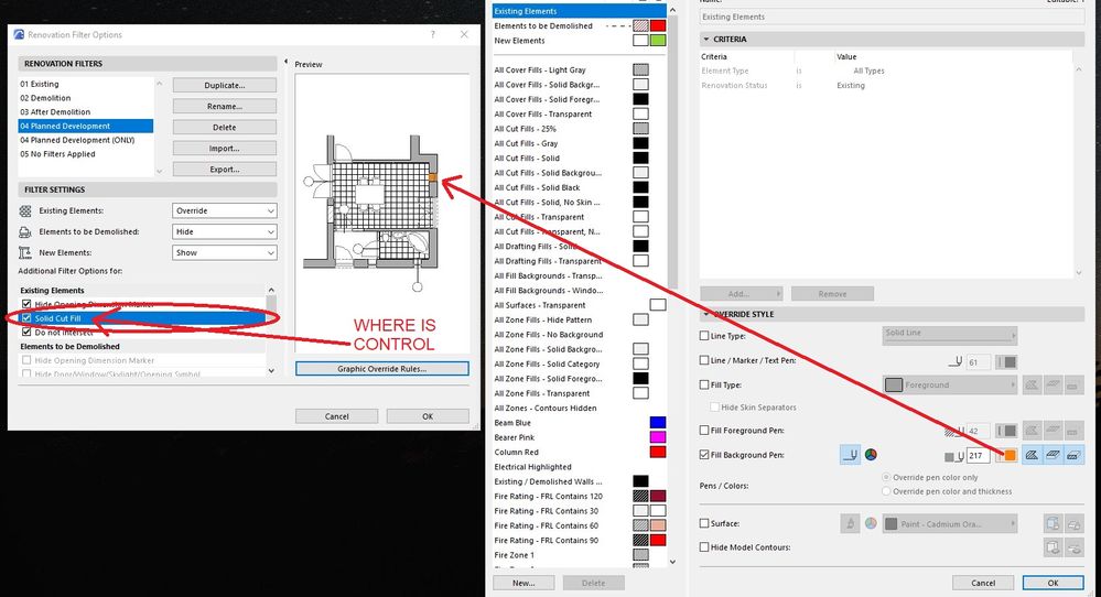

HI,
I'm looking for where in Graphic Override Rules how to control "Solid Cut Fill", tick box.
There appears to be 3x rules called Solid Cut Fill, one Black, one Grey & the other white?
Please see attached.

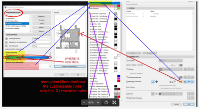

Renovation Filters do not use the rules that you can customise or create - the Graphic Overrides use these.
They only use the 3 renovation rules.
The 'Additional filter options' are just options you can turn on/off.
In your case for '03 Planned Development' you have told the 'Existing Element' to use 'Solid Cut Fill'.
So it will use the cut fill set in the 'Existing Elements' rules - and not any of the other rules that are only for Graphic Overrides (crossed out in purple in my image).
At least that is my understanding of how it works.

I see.  Thanks Barry.
