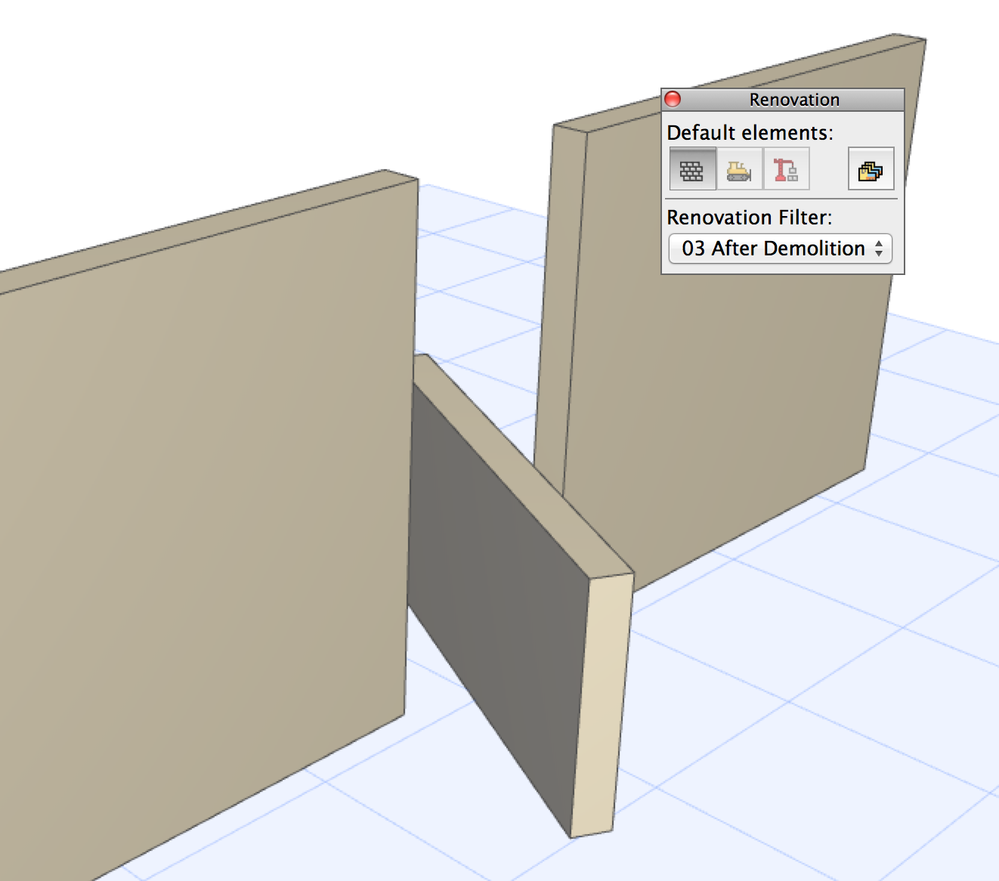

Eduardo Rolon
Showing "After Demolition"
BTW I am using AC15 for this.

Ok, so really I will need to use two different renovation filters to get the results in 3d, i.e. 'New Construction' in the plan view so the red lined 'to be demolished' elements are shown, and then the 'after demolition' filter in the 3d view with 'hide' selected for the items to be demolished. This works for me now which is great! Thank you kindly ejrolon!
