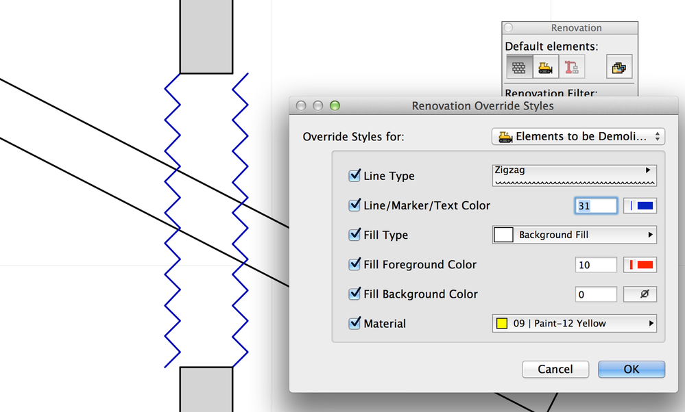

Hello Experts!
Please help me find a solution to this problem.
I have tried to set my renovation filter to show my demolished elements as transparent but with a red dotted outline. For some reason, the demolished elements now show as a solid background fill which is contrary to the graphics in my renovation filter options.
Does anyone have any ideas how to sort this?
The same element also shows up in solid red in the 3d model view which I also want to change.
Thanks folks...
Paul

Uncheck "Material" (or change the material) in the Renovation Override Styles dialog box.

Here are my settings.
