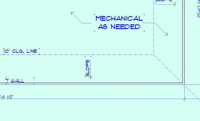

Yes there is.....
Select the roof and then Tools:Create Roof Level Lines. Input the ceiling height (or the clip height that you want). The lines will appear.

Thanks.. Though they have to be regenerated whenever the roof is changed that helps.
