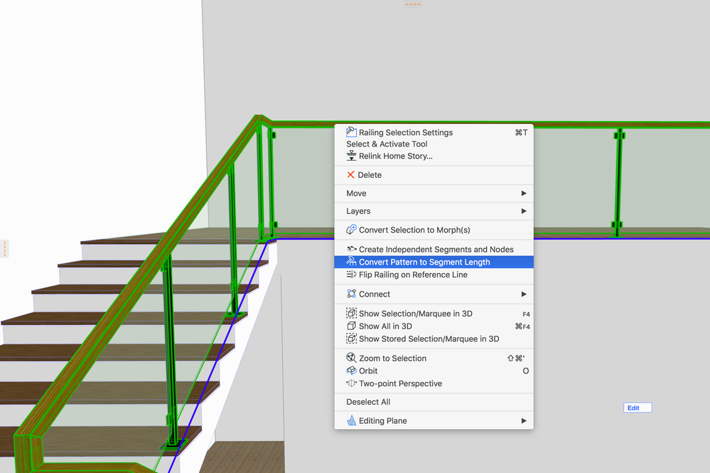

  • Select the Railing and do a right click.
  • Select the option 'Converting Pattern to Segment Length' from the Contextmenu.

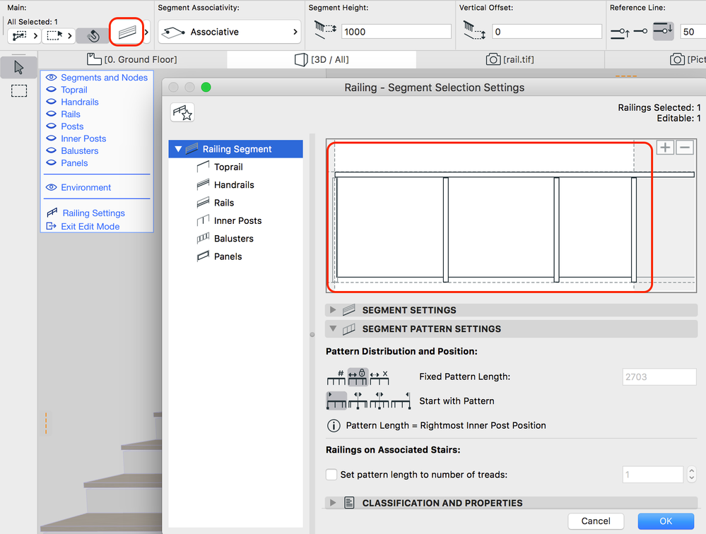

  • Go to Edit mode by clicking on'Edit' button. The button appears next to the selected Railing in a blue-bordered box.

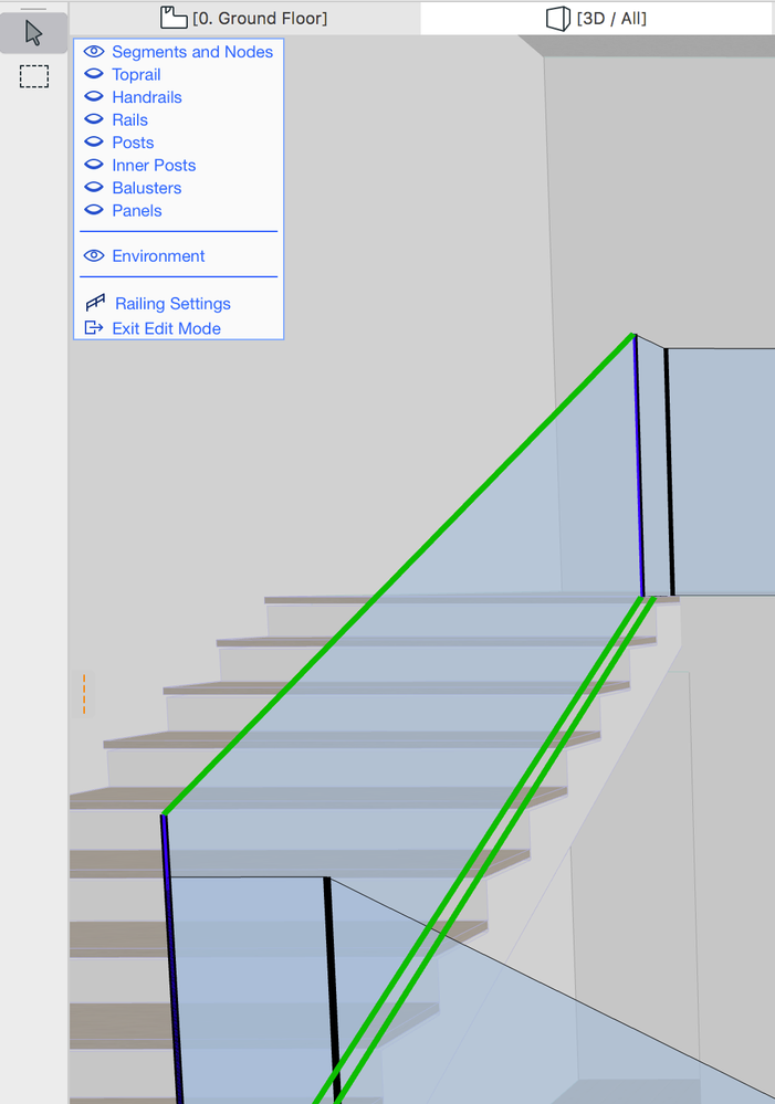

  • In the upper left corner the Edit Mode Palette appears. Do a right click on 'Segment and Nodes'. (Doing a right click on that option makes all the other elements invisible and the 'Segment and Nodes' visible.)
  • Select the Segment, its Pattern you want to edit and open the 'Railing - Segment Selection Settings'

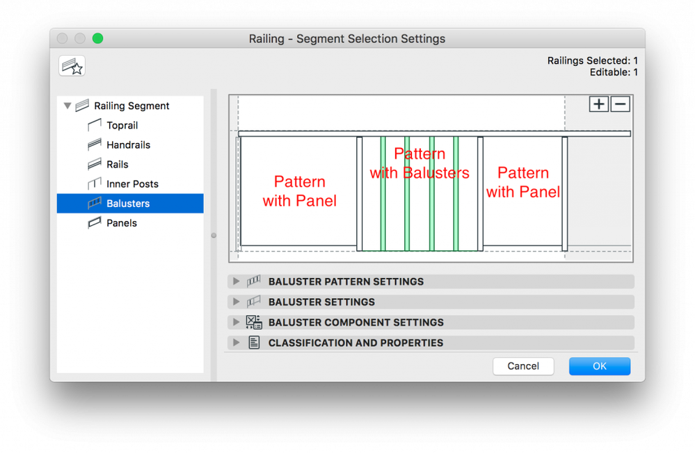

  • If you check the Segment Editor, you will see that not only one Pattern is active (highlighted with white) but all the Patterns were available in this Segment.
  • Now it is possible to change the settings or delete/add Inner Posts, Balusters or Panels to each Pattern in this Segment. (Note: all the horizontal sub-elements like Handrail etc. will go through all the Patterns as one element.)
  • After finishing the editing of the Railing Segment, click ok and exit the Edit Mode by pressing ESC.
