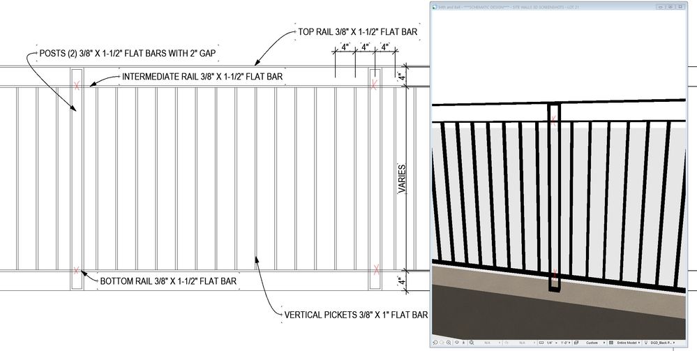

I have developed a custom inner post that has a 2" void in the center. The intermediate and bottom rails continue through the custom inner post. Does anyone know of a way to interrupt the rails? I looked at making a custom panel, but that is not available.

Hello @rgarand,
Did you try to use SEO ?
I use to ajust my railing modelisations by this way.

Yes.
Just go into edit mode for the railing and SEO the elements you want.
You may need to use subtract upwards/downwards seeing as your post has a void in the middle.

An SEO within the Custom Post Object?

Yes.
Ahhh excellent...and when you pick one Inner Post they are all selected. This worked great, thank you. Screenshot 2023-03-29 090400.jpg
