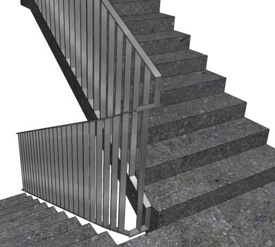

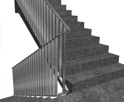

So, I have this really simple railing, but I just dont know how to model It in archicad. I swear I tried everything but I cant get what I want even thought its the simpliest railing on earth.. Any help please?..

Perhaps you could flip it changing the reference line option.
Anyway, stairs and railing are quite complex tools to learn, so I recommend you take the available courses from Graphisoft Learn: Stairs and Railings in Archicad

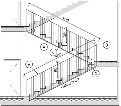

If you look at your section, you will see that the railing extends past the treads from the landing, compared to your model where the landing starts on the line of the treads. I generally place a stair node at the end of each run so that I can define the landing seperately, partially for this reason.

... the railing extends past the treads from the landing
^^This!

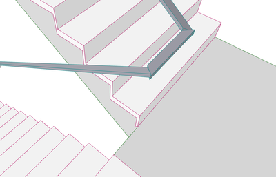

And that: You need some extra points, half the width 'further right'. Railings don't do 'banking'...
What you paid for:
What you need:
What you do:
As one can see, the tool isn't capable to solve this with further help.
Might be possible to solve the self-intersection though...

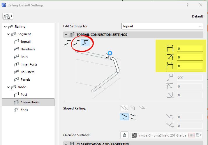

I don't have time to experiment at the moment, but have you tried the different connection settings?
Gooseneck or Direct.
And you may need to adjust the the lengths and radius of the transitions.
