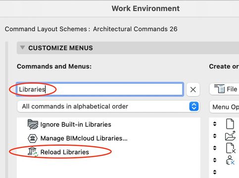

Is there a command to refresh all libraries (same as 'Reload and Apply') without needing to open the Library Manager, clicking or reload and then closing the window?

I believe this command is what you're looking for...  You can add it to a menu... or add a shortcut key combination for it.  Note that there are quite a few commands available in the Work Environment that don't exist in the standard menu structure.  You might find something else useful in the list of all commands...

Thank you Karl
Yes that was it.  I did do a search for 'reload' but nothing came up
I was missing the "All commands in alphabetical order" in the drop down below the search bar
