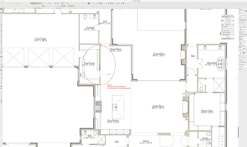

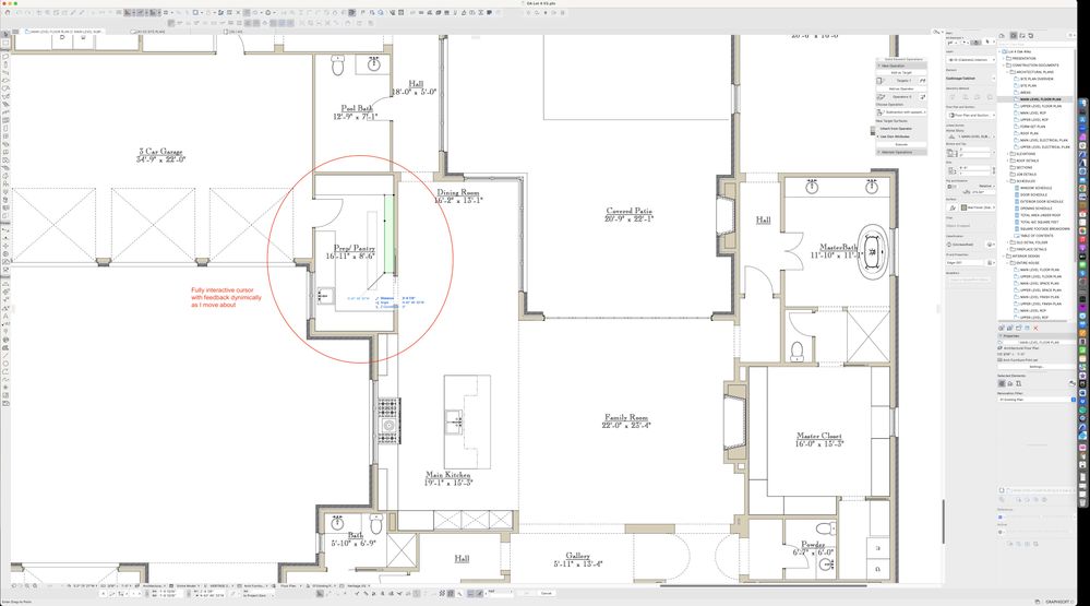

So I am noticing that the feedback on the cursor disappears in Archicad 26 after I change some of the parameters in the info bar. So for example, I change the width, or the height of an object by clicking on the info bar parameters box, then when I go back to the 2D window, my cursor feedback (the ability to see dynamically how I am moving an object, or how long it will be, or the ability to snap to another object) is disabled/ missing. If I click on the info box window (or out of the 2D window), this interactivity comes back.
