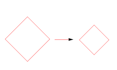

Hi, Does anyone know if it is possible to resize all elements individually, so they would all get smaller from the middle point?
The problem is that when I choose all morpfs, they resize all together and no tindividually.
Tnx!

This is not going to be possible because the Morph is not parametric, so you would have to resize every single square.
Some of the options you have:
1. Use Rhino/Grasshopper and the Archicad-Grasshopper Connection to model it and make it parametric.
2. Use PARAM-O within Archicad to create a parametric Object element, and when you are satisfied with the result, you can even convert it to a Morph or keep it as a parametric Object.
3. You may be able to model it using the Curtain Wall tool, and when you are satisfied with the result, you can even convert it to a Morph or keep it as a Curtain Wall (it may have lots of polygons in 3D).
