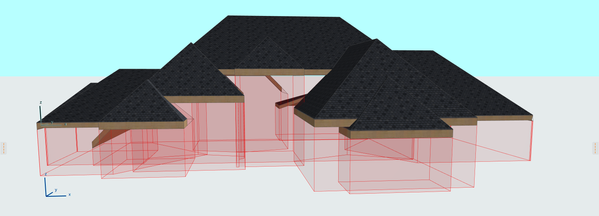

Roof shown in 3D window
Hi, I'm not sure what setting I did, the roofs shown as picture have frame visible, and I didn't find how I should disappear it. Can anyone tell me how to solve it, thanks

You have turned on Trimming Bodies under On-Screen View Options.
Daniel_He
Got it, thanks
