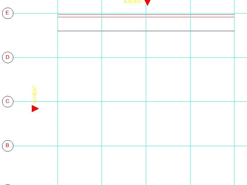

and a quick shot of my very empathy plan ??
Ian
The result of solid ops don't show in plan. It's s long standing wish.
