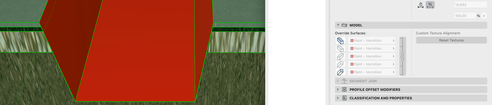

After performing SEO, exposed part of Target element shows surface which is set as Override Surface in Model section of Element Settings (either Operator or Target attribute), even if it is not enabled/turned on.
Is it not able to show surfaces of each material if Target is Composite Element?

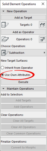

Did you choose this option in the SEO dialogue?
LukaS
Yes.
Does this regardless of type of operation also.
See attachment.

When set to 'use own attributes', the SEO does use the end surface material of the complex profile.
Whether the end override is on or off.

So, SEO will use the end surface materials (whether override is on or off).
If you want to see the actual materials, don't use SEO.
Use the automatic trimming of elements.
