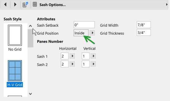

Yes.   As you can see from the picture I posted it works just as expected.  Perhaps you have a corrupted library part?  What version of 25 are you using?  I see that the name of the Window Object is not the same as mine.   Just trying to rule out a few things.
Another strong possibility is that you have the Grid position inside and transparency is turned off in your 3D Styles settings - cant see them through the non-transparent glass ?
