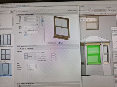

Sash bar/grid not showing up in Elevations
It shows up in 3d but not in my Elevations.
Where is the setting hiding?
3 Replies 3

update your library ?

Sandramuller
Can you explain why I should do that if I can see the bars in 3d?
I thought it might be a mvo or sth like that.
Steve Jepson
Yes.   As you can see from the picture I posted it works just as expected.  Perhaps you have a corrupted library part?  What version of 25 are you using?  I see that the name of the Window Object is not the same as mine.   Just trying to rule out a few things.
Another strong possibility is that you have the Grid position inside and transparency is turned off in your 3D Styles settings - cant see them through the non-transparent glass ?
