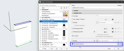

Ricardo Lopez
Hi @alexliz
Just one more test to be done: please check if you have an applied Graphic Overide Combination where there is a rule with the option Hide Model Contours checked.
Ricardo López, M. Arch.
alexliz
Hi @Ricardo Lopez , thanks for this. As you can see from the video, when I switch to a different Building Material all shows correctly. Not being affected by any GO (which I am not using here to begin with). Good shout, I wish it was this.
