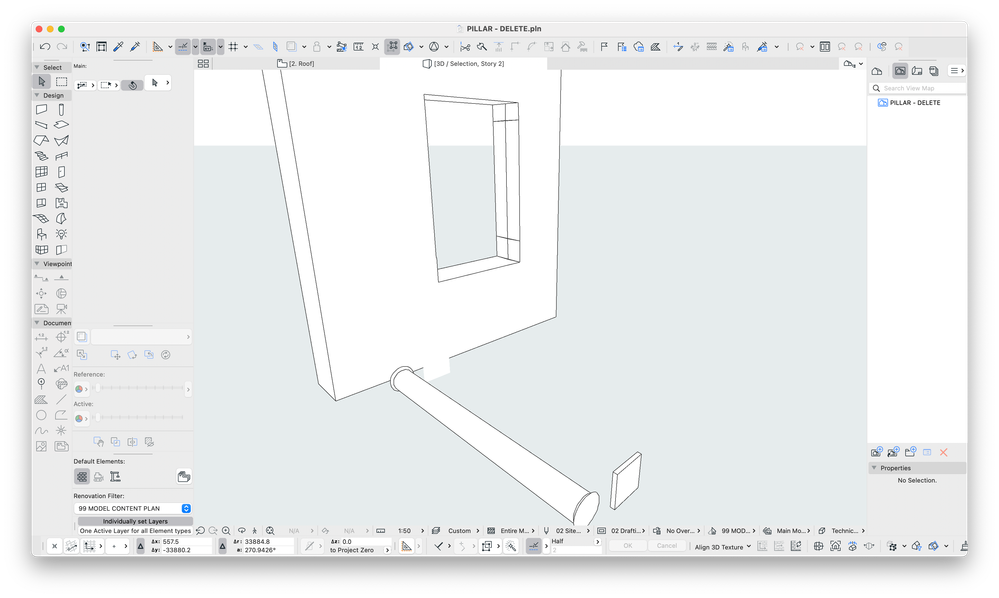

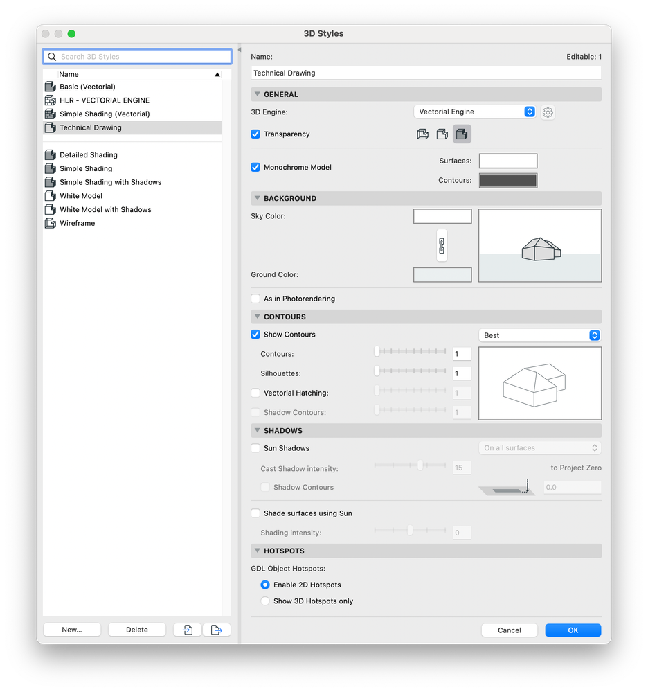

Hi all,
I've got this very simple Slab Element which, when viewed in 3D using the Technical Drawing options as set here:

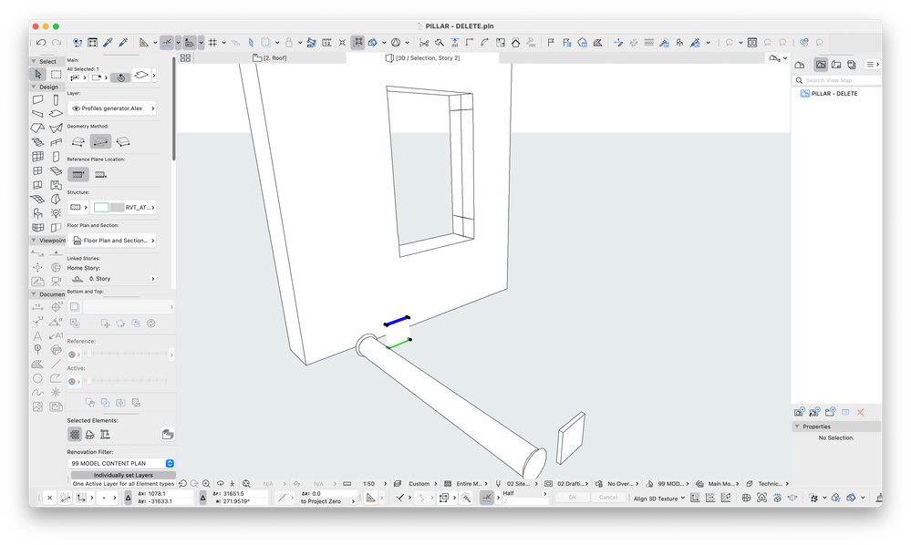

refuses to show any contour lines whatsoever. If I select it in 3D I can see it; but if it's not selected then not. Compare the two shots below:
  The Building Material I have used for the Slab came from a Revit import. I suspected something may have been wrong with that BM, so I checked one-by-one all its parameters, against the material of other elements, but couldn't identify anything.
Oh, and that wall in the back? It's the same BM, and yet it shows normally.
I've pulled all my hair. Any pointers as to what I may be missing will be so welcome. Thanks!

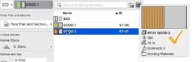

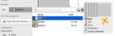

I have placed these elements in a new file, with a single layer. Issue still there. Very odd. I have attached a video - anyone feel free to watch and theorise, no matter what I do, all slabs get affected by this material, 'BAD': when it's applied to them, they lose all lines in 3D view. I give up.
File contains only the Archicad Layer; 3 Building Materials, 2 Surfaces, few default Fills, Solid Line Type only.
Literally stripped down to bare minimum.
Archicad 27 macOS Sonoma
Hey @alexliz,
I think it's a texture issue, see this link below,
Archicad 27 Help (graphisoft.com)
compare these 3 shots from your video, they're for the 3 BMs, why the first one has no boundary box for the texture while the others have??
