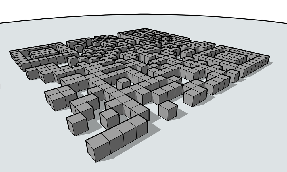

How to generate HR images with different contours and silhouettes as in 3D Style Settings?
We have the choice to set different thickness for 'contours' and 'silhouettes' in the 3D Style settings and this can result beautifull drawings, but I could not find a way to generate images for output with these settings, other than taking screenshots (like I did for this post). But the screenshot method has a limitation of image size (the screen size).
If I generate a view from the 3D window and insert it into a layout, the thickness of countours and silhouetes are the same, not as set in 3D styles.
Screen Shot 2022-03-09 at 20.30.13.pngScreen Shot 2022-03-09 at 20.30.05.png

Durval
Thank you for the suggestions. I don't think there is this option to set different thicknesses for 'countours' and 'silhouettes' among the Photo Render options (at least I didn't find any).
Anyway, I must correct what I said above, as it is not quite right.
When I inserted the View generated from the 3D window in the layout, it looked like all lines were the same thickness. But then I published the layout and opened the just created PDF, and realized there was in fact a difference between contours'  and silhouettes' thickness.
The difference in the PDF is much more subtle than in the 3D window, but it was there.
I attached two screenshots, one from the 3D window and another from the PDF of the layout in which the View of the 3D window was inserted. See how different are the thicknesses!

Have you tried doing a Photo Render.
Go to Photo Rendering Settings and choose 'Sketch' as the engine.
Then you can adjust the settings to your liking.
Click on the preview and you will see what you have set (it is a standard preview image - not of what you are rendering).
When you have the settings you want you can store the scene so you can use it again.
Actually now I look closer, not there is no contours and silhouettes in the rendering settings.
Just sketch lines, (that would be both contours and silhouettes), hatch lines and shadow lines.
Seems contours and silhouettes is purely a 3D style thing.
Lingwisyer
Guru
What happens if you turned on True Line Weights? Not sure if this does anything in the 3D window, or if it was already on.
Durval
Pen thicknesses are not considered in the 3D window, only pen colors. Thicknesses are controlled by the 3D Style settings.
