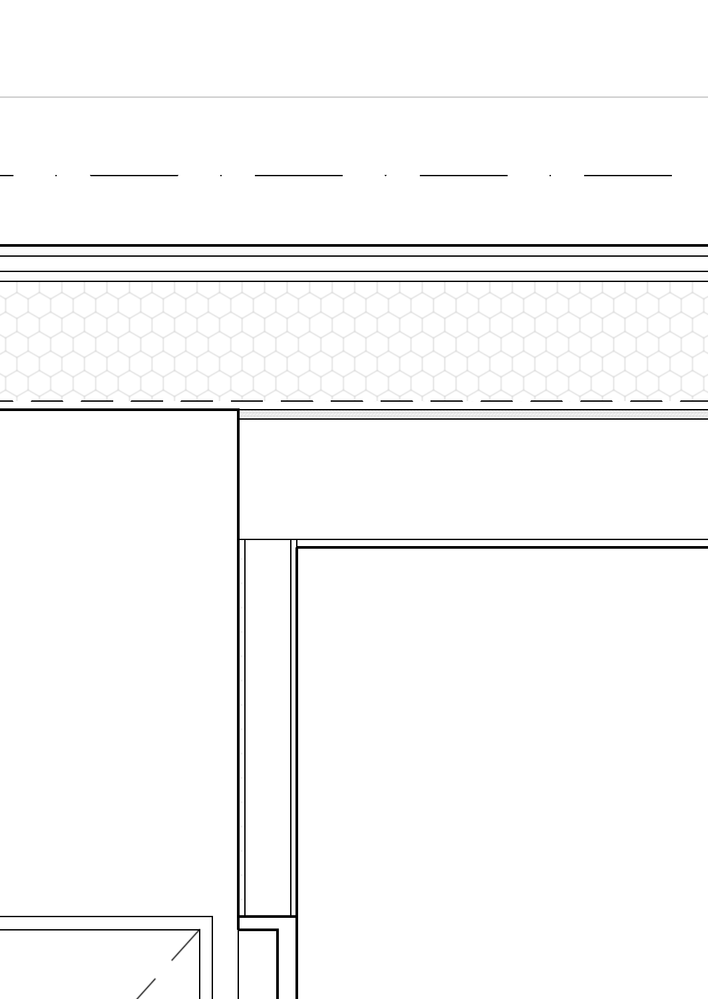

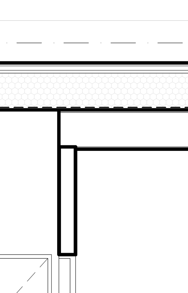

Hello - I would like to see if there is a way to get an overall contour cut line of overlapping elements in section, without showing the elements as separate entities ?

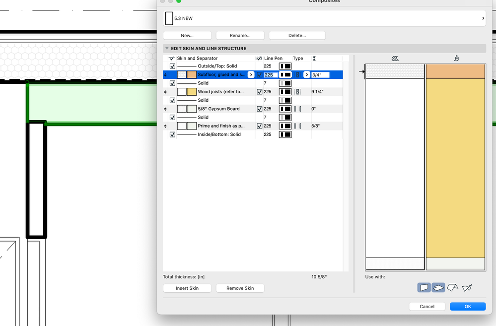

The wall shown here seems to be intersecting properly with the dropped ceiling (floor structure) and the outline is represented properly when I have true line weight turned off; however, the wall end lines appeared with the true line weight turned on. Any advice on how to go about this would be appreciated! Thanks.

Don't worry so much about what you see on screen.
What does the printed output look like? - you may not even notice it depending on the scale.
It looks much worse on screen due to scale and the fact you can zoom in.
Possible solutions.
Try display order - send the wall backwards or the dropped ceiling forwards.
You may still have a problem with half a line thickness still showing - this is just he way Archicad does it lines - thickness is from centre of line.
You can change the pen of the composite end lines to make it thinner or you can turn it off altogether - but this will also affect your plan and other sections.
If the printed view looks good at one scale and not another, you can use a different pen set for each view where the thickness of the pens are different to suit the scale - i.e. smaller scales you might want to use thinner pens possibly so you don't lose the detail of the thin skins in the composites.

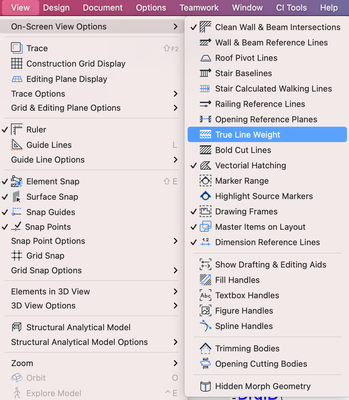

are you using "bold cut line" or "true line weight" in the on screen view options?

The view printed is similar to the true line weight view but not as jarring only because it's on a larger sheet, but it's still not as clean and legible as a drawing to read what is actually the contour of the finished surface. I guess I will have to deal with this limitation for now..

The screenshot with True Line Weight turned off has Bold Cut Lines turned on, but seems like there's no way to capture that setting for print? Because the bold cut lines is actually the result I want.
