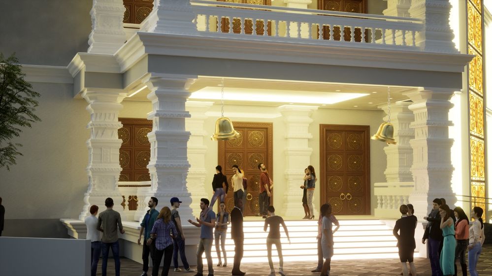

Any suggestions on how to achieve something similar to the image below.
I'm thinking the method would be to create one segment as a curtain wall panel then repeat using curtain wall.
But haven't done before and be interested to see what other users have done.

I use my own custom objects for things like that. I like my control lol.
I'm curious too as I have never used the curtain wall.
Given my knowledge now I would use my wall coverings and a little gdl to do exactly what you see.

Are you required to provide drawings to produce this scrollwork? If not, could you just use a texture? This being even more viable in 25 given that you can show actual textures in elevation and section?

i think you can create a complex profile for curtain wall then replace the panel of that curtain wall into that complex profile. 🤔

Unless they have fixed it, the issue with Custom CW Panels is that they do not trim to the boundary...

If you looking for just for the presentation then you may try this exercise shown in my you tube video. https://youtu.be/6048x8LpFcM
Not suitable for any detailing or such design needs.

Curtain wall can work for repeated pattern. This also can be done with railing.
You should go crazy and model everything... like Vinoth did here... all in all, over 9 million polygons are already in the model, and the work is ongoing...

my first impression: model one segment of the panel with a slab, save the slab as a rail panel, model the full width/length with the railing tool
second thought: photoshop a png with transparent background, model as a morph with a surface using the png (downside would be it would need to be 0" thick)
third option would be to model the repeating panel with a slab as suggested above, save as an object, and add a ROTx 90 line at the front of the 3d script and replace the 2d script with PROJECT2 3,270,2; then place and copy the pattern around
This is perfect other than the only thing I would say is that if you save the object in asymmetric view correctly the 2D will be what you want without a rotate command
ryejuan
how's his computer handling it?
