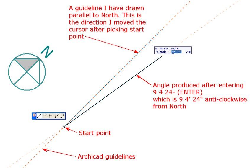

Hi Jess,
Sorry, I was unclear.
When you have picked the first endpoint of your boundary, move your cursor in the direction of North (this does not set north, you must know where North is!). By entering "A 45- ENTER" you are saying you want to go 45degrees anti-clockwise (as angles are normally measured clockwise by AC, but anti-clockwise in the real world).
Not sure about your angle co-ordinates. If I check Surveyors Units or Degrees, minutes, seconds I get the same thing here.
Does this make more sense?
So-

After starting the line move your cursor in direction of north, in your case 45°, hit "A" input the angle, hit the MINUS key, then hit enter.

Not sure what S 9° 04' 24" E means. You may need to rely on advice from someone who speaks the same survey language. The way we show boundaries here is just an angle relative to north, north being 0°. Can you give me a diagram of what your co-ordinate means?
