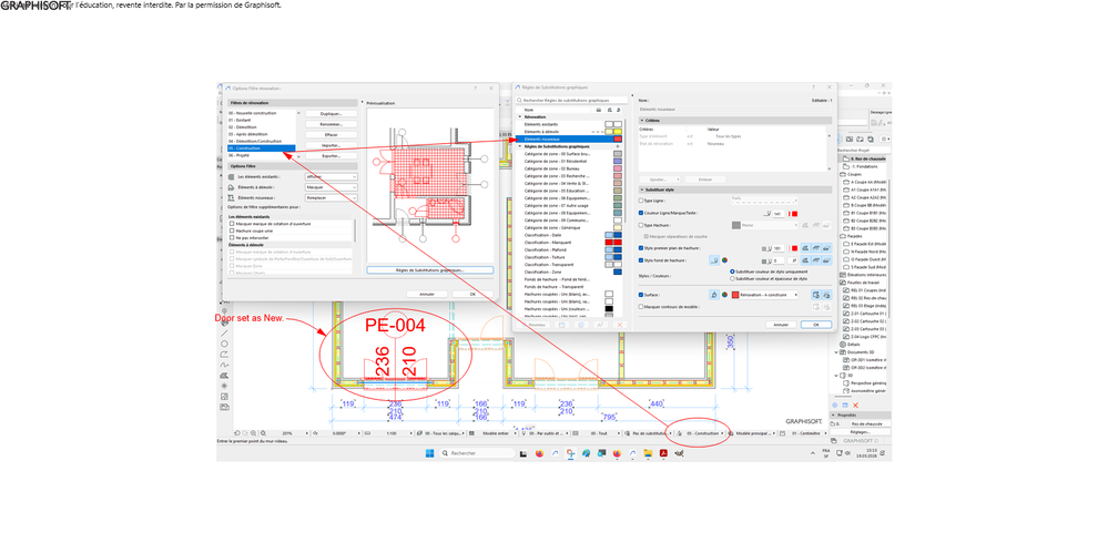

BrunoH
Hi Kelly,
If your are not in a Renovation project, as a Workaround you may use Renovation filters.

thats really weird... so overrides via renovation work for the whole window, but not through the graphic override? so strange!
