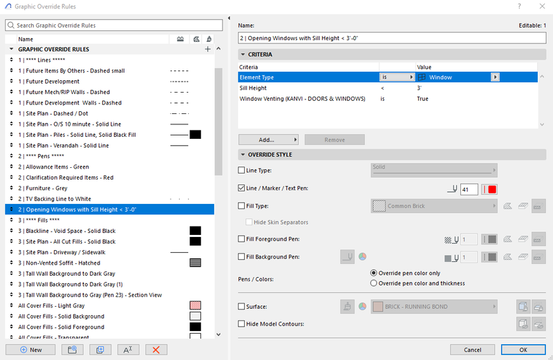

Is it possible to create a graphic override that changes the color of the window marker text based on the sill height of the window?
I want windows with a sill height < 3'-0" and a custom property of "Window Venting=True" to change the text color of the window marker from black to red. This is what the override is so far, and while it changes the window lines to red, it doesn't seem to affect the associated markers. Having the lines of the window change to red is ok, but quite often we model windows stacked one on top of another, so this doesn't always work. (We often have unique and complex combinations of windows and have not found a window object that meets our needs, so we find it easier to model each unit separately.)
