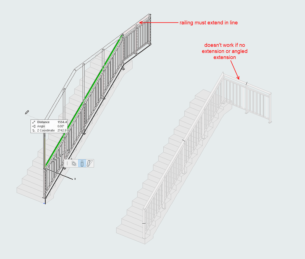

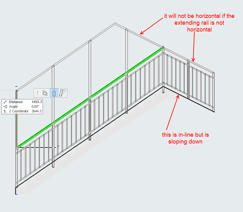

It seems that it will only work if the sloping railing is extended in the same line.
If there is no extension or the extension turns at an angle to the loping rail, then it will not work.
So you will need to have a portion of the rail that extends horizontally to begin with.
I also notice that if that extension is not horizontal, then the adjusted rail will not be horizontal either.
It will match the angle of the extended rail.
So it really only works when there is a horizontal, in-line extension to the railing.
