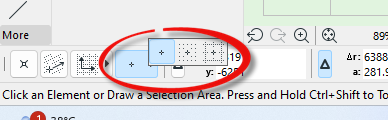

Is it possible to enable simultaneous snapping to regular geometry and construction grid or snap grid?

If you are referring to snapping to geometry that does not align to the construction grid the answer is no.
In the sample below if grid snap is on you will not be able to snap to any object.

Fortunately you can set up a keyboard shortcut to toggle between snap modes, which I am guessing you are aware of.
Just noting it so everyone is aware.
SHIFT+S I believe is the default shortcut, you could even change it to just S (or something else).
Myself, I always have the co-ordinates palette active for this and other options, so it is just a quick button swap.
