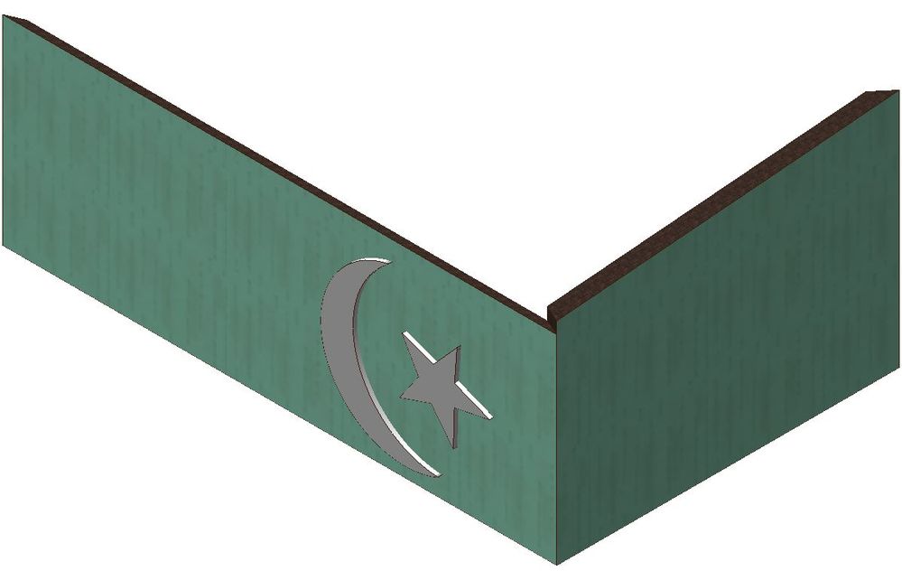

Having completed a successful library object, we have tried to use it as the operator to subtract an opening in a vertical wall plane.
The objects depth extends on both sides of the wall surfaces.
However upon execution of the operation the desire result of a hole in the wall does not materialize.
What are we missing?

Screenshot? Preferably a 3D view showing the wall and the object?
Does your object have a relevant zzyzx parameter ? I had some problem with old library parts not using this "standard" parameter and SEO wouldn't work... I had to make use of it for SEO to work

Here's a 3d and a plan view

Michael
Duh Michael turn the operator layer off.
Issue resolved

Djordje
Issue resolved
You can also make the operator layer wireframe, if it helps.
