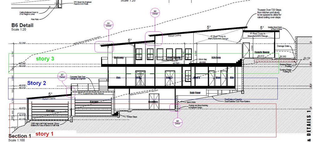

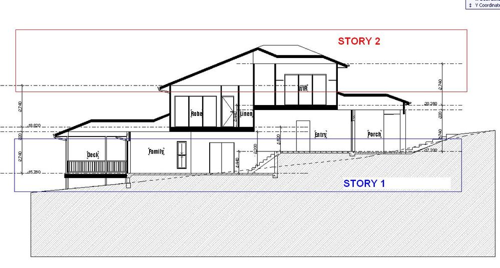

most of my work is multi split levels.. i just use one story for the all levels and set all the walls outside the cutting plain to "symbolic cut". been doing this for 3 years and never had an issue.
heres an example of 2 of my current jobs
