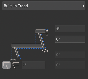

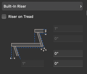

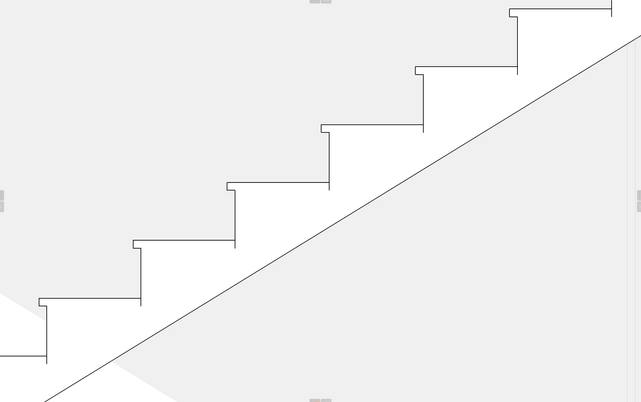

This is the second time I have encountered this on a project, but have yet to find any direction. When I try and create a simple contour of a stair in section, there is always a graphic error showing vertical lines extending past the treads and connecting to the structure. Typically, the stair wants to default to a small gap between the stringer and treads, but the problem persists when all of my tolerances are set to zero. Any tricks for this sort of thing?

presumably the tread/riser is the same bMat as the stair body?
I am seeing it merging together... until I zoom way in. The line does not appear to print on my end, but is annoying.
one solution may be to turn off the riser, and have just the tread and stair body.
