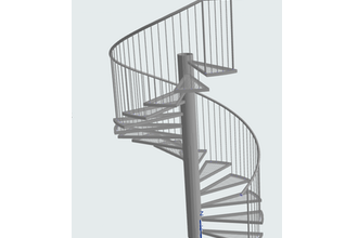

This article provides a step-by-step description for creating a metal spiral stair having a column in the middle. The unique thing in this example is that the structure of the staircase is part of the tread. To see how to place a general spiral stair, click here.

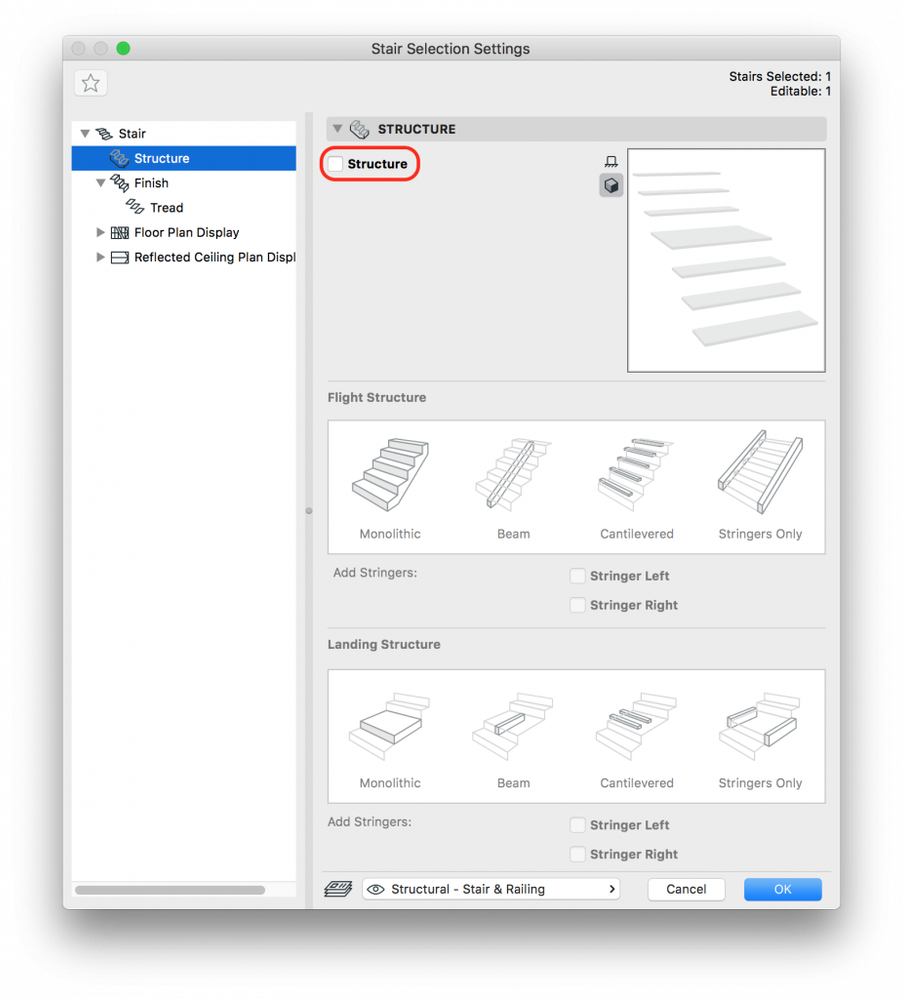

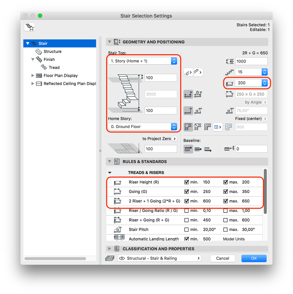

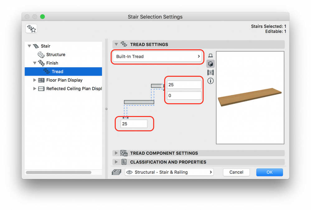

  • That type of stairs have quite a big riser and small inner circle.

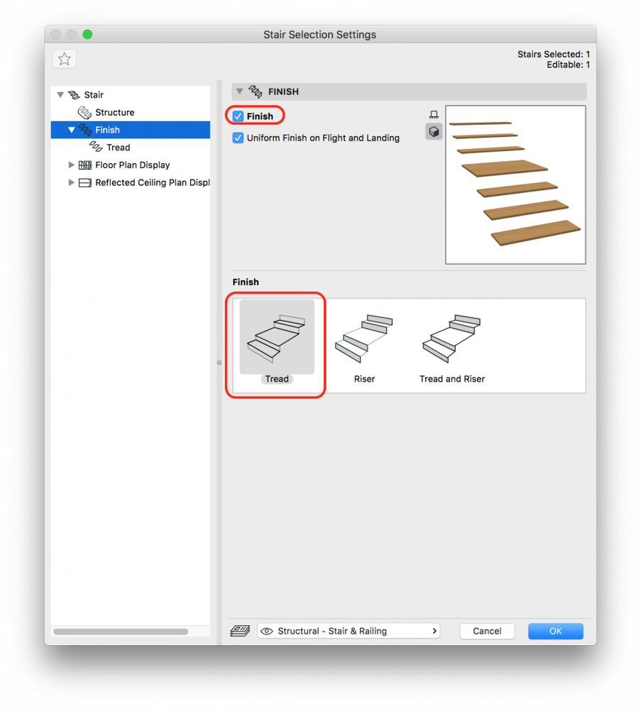

  • The stair should not have any structure.
  • The Finish should contain treads only, no risers.
  • In this example the Built-in Tread was used with a thickness of 25 mm, 'Tread Gap' is 0.
  • Let's place the stair. (To see how place a spiral stair in general click here.)

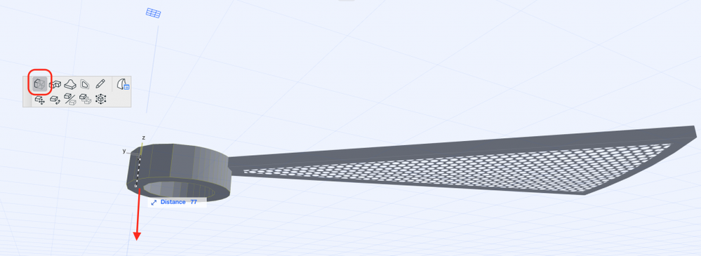

  • In 3D click on of it's edge on the top of the Morph and select the 'Offset All Edges' command from the Pet Palette. (You might need to change the position of the Editing Plane to 'Horizontal')
  • Press Alt ( on Mac) or Ctrl (on Windows) to offset the copy of the edges.
  • Press the Tab button and enter about 30 mm to the Tracker.
  • Press Enter.
  • Do the same at the other side (at the bottom) of the Morph as well.
  • Open the 'Morph Selection Settings' and change the Building Material of the Morph to 'Steel' and disable the 'Surface Override'.
  • Click on OK.
  • Select the top and bottom faces with Ctrl+Shift+click
  • Open the 'Morph Selection Settings' and override the selected surfaces to a perforated steel surface.
  • Do the same for the other side of the Morph.

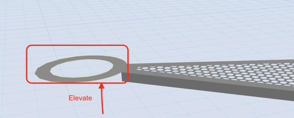

Creating the structure

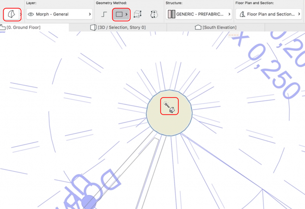

  • Navigate to the floor plan
  • Place a Morph using the 'Straight' Geometry Method in the middle of stair. Place a Guide Line and use the Magic Wand (space + click) for placing the Morph.
  • Select both Morphs by activating the Morph Tool in the Toolbox and press CMD+A (on Mac) or Crtl+A (on Windows) . Do a right click and select 'Show Selection/Marquee in 3D' from the context menu
  • Click on the edge of circle and select 'Offset All Edges' command from the Pet Palette.
  • Press Enter.
  • Press Ctrl+Shift and click on the inner surface of the Morph.
  • Press Backspace to delete that surface.
  • Select the Morph and elevate it by selecting the 'Move' command from the Pet Palette.
  • Click on the surface of the Morph and select the 'Push-Pull' command from the Pet Palette.
  • Start to pull the surface.
  • Press the Tab button and enter 200 mm to the Tracker.
  • Press Enter.

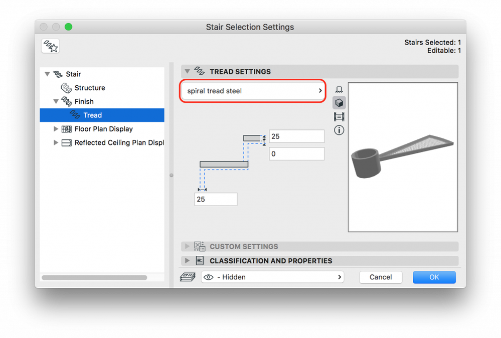

  • Select the Stair and open its setting.
  • Select the Finish › Tread on left and click on the 'Reset Custom Treads' at the bottom of the dialog. This command puts back the missing first step.
  • Navigate to ‘Tread Settings’ on the right, click on ‘Built-In Tread’ and select your custom made Tread.
  • Click OK for saving the settings and finishing the stair.
