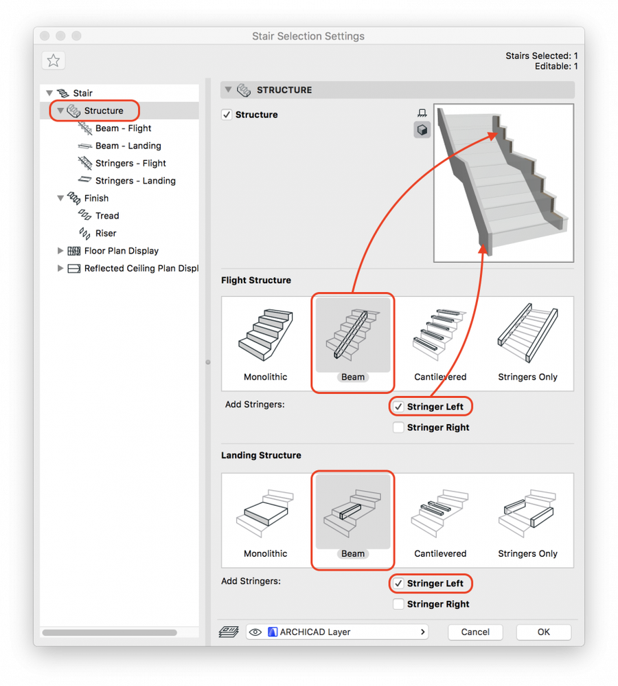

To achieve this type of Stair structure, we will choose 'Beam' structure for the flight (and landing).
For the opposite edge of the Stair add Stringer by ticking the box, optional 'Stringer Left' or 'Stringer Right'. Stringers setting will appear under 'Structure' tree menu.
In the 'Beam – Flight' structure settings choose 'Open Stringer 21' as a Beam type.

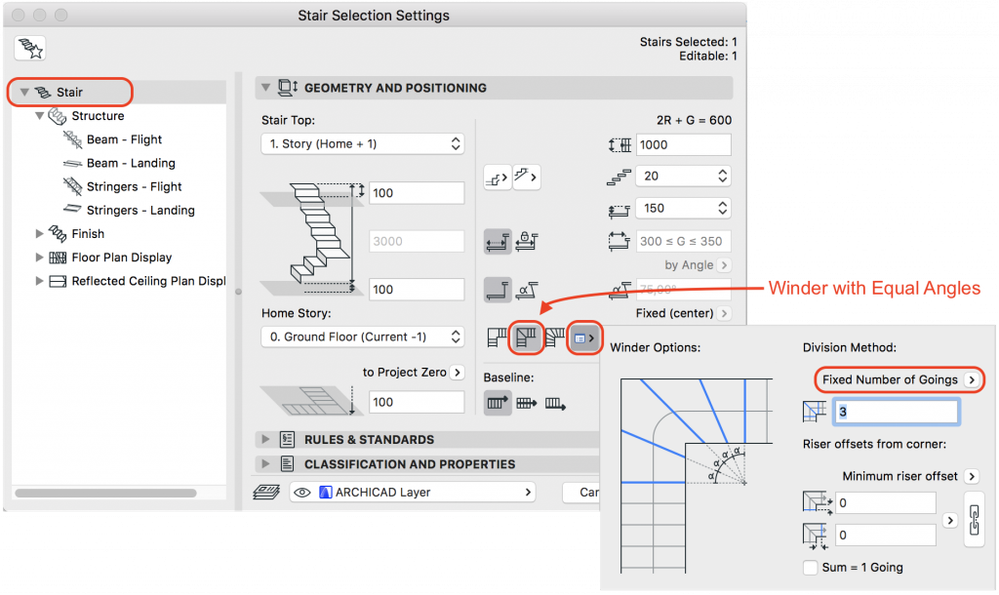

This type of the Stairs is usually made as a winder type so under 'Stair setting' in 'Geometry and Positioning' we will choose 'Winder with Equal Angles' and under Winder option set 'Fixed Number of Goings' to 3.
