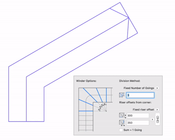

L-shaped Stair example
In this example we will construct an L-shaped Stair with the Segments being standard 'Flights', and the Turning being 'Winder with Equal Angles'.
  1. Open the Default stair settings dialog, and set up the story height and your stair rules according to your taste or local standards.
  2. For Turning Type select a 'Winder with Equal Angles' and set up it's settings according to your needs by clicking the Turning Type Options button (next to it).In this example we know we want 3 treads, and the risers to extend 0.3 and 0.5 going lengths from the corner.
  3. Now all that's left to do is placing your L-shaped stair with 3 clicks in 3D or the Floor Plan View. You can see how our rules got applied below.
NOTE: If the result is not quite what you were expecting, you can fine-tune the Winder settings in the Stair Settings dialog, or by clicking on the corner (Turning node) and selecting Turning Settings from the Pet Palette. You can find out more about this here.

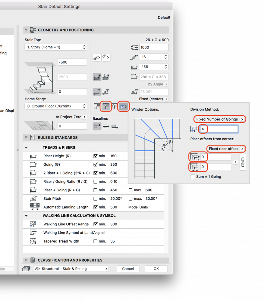

U-shaped Stair example
In this example we will construct a U-shaped Stair with the Segments and the Turnings both being 'Winder with Equal Angles'.
  1. Open the Stair Default Settings dialog, and set up the story height and your stair rules according to your taste or local standards.
  2. For Turning Type select a 'Winder with Equal Angles' and set up it's settings according to your needs by clicking the Turning Type Options button (next to it). We know we want to have 4 treads, and we are going to use winder segments to define the end of the turning, so we want no offset.
  3. In the Floor Plan (or the 3D View), click to start drawing the stair.
  4. After drawing the first flight, change the segment type on the pet palette to 'Winder with Equal Angles', and draw the 3 segments of the turning.
  5. Choose the 'Flight' Segment Type on the Pet Palette again, and finish the stair.
    You can see how our rules got applied below. In case of winder segments the offset is calculated from the end of the segment, not the corner.
NOTE:Certain Rule and Turning combinations may not work with this stair shape, as their rules contradict. In this case the Solver panel should pop-up and offer you alternatives.
